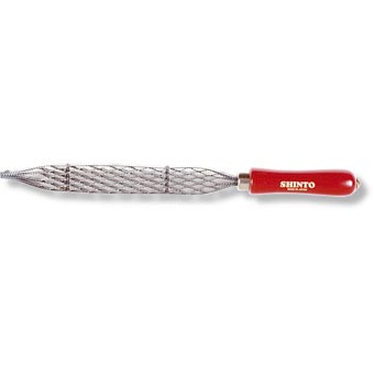

Just this one guy's opinion but I'd save the money on a spokeshave and spend it on a Japanese Saw Rasp. It's a bunch of hack saw blades attached together in random fashion to make a rasp. Works like a dream.

Can I second Paul's opinion about the saw rasp. I got mine from Axminster (in UK), fine one side, course the other made up of double sided saw blade material in a lattice 25mm x 230mm. As they are a lattice waste just falls right through. And all for ?8 against ?50 or so for a good spoke shave.

Josh, colin hit the nail on the head. That's the exact rasp I have. If it's quick stock removal you want, this will do the trick. In fact, I don't often use the coarse side as it can be a bit TOO aggressive. Do a google search for "shinto saw rasp" and you should have good luck. I think I paid around $11 USD for it.
PostPosted: Mon Dec 05, 2005 2:04 am
News flash! they have gone up a bit in price. Saw Rasp

FYI...Japan Woodworker also sells the saw-rasps. It has turned into my go-to tool for hogging off wood in a controled manner. The Nicholson rasps are superb tools and make a good follow-up to the saw-rasp cuts.
By the way, I find I virtually never have a need to use the "plane" attachment on my saw-rasp (I just use the bare blade)--it's quite unstable due to the narrowness of the blade. The next one I buy will have the straight handle. Just buying the replacement blade is also an option, but the sharp teeth make it uncomfortable to hold.CarltonM38691.6839699074
